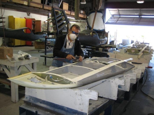

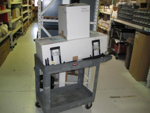

Spend the day sorting the hardware components and sanded the wings to prepare them for closing.
Sanded the open bottom wing spars and other contact areas for bonding. No shiny surfaces are allowed.
Attached and tightened fuel vents/check valves prior to closing top skin of wings. Later the mini NACA scoop will be cut thus allowing the venting and the pressure build up to occur.
Wing were closed using a mix of HYSOL/FLOX at the right consistency then applied with trowel on the acetone cleaned up surfaces

Kit Components
Kit Components
Sanding wings prior bonding

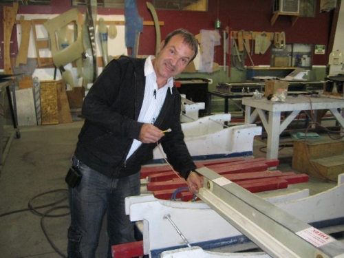

Pulling Nav antenna/light draw wire
