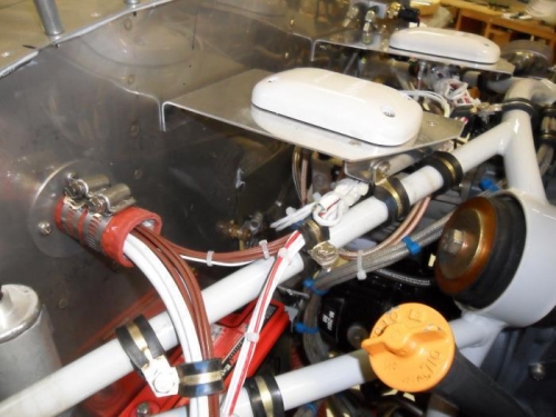

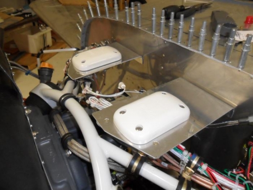

• Attached right side GPS antenna tray, installed BNC & TNC connectors, and installed GPS antenna.

G3X antennas installed and top wire bundle finished
