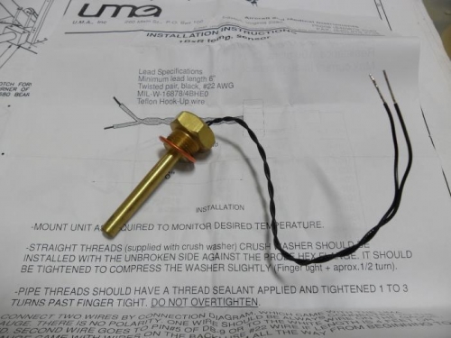

--Installed the oil temperature probe and safety wired it. I couldn’t find any documentation that mandated using safety wire, and in some places on the forums people suggested that the crush gasket would serve sort of as a lock washer, but there was a hole in the plug for safety wire and I always need the practice. It only took me two attempts to get it right, I’m getting better.

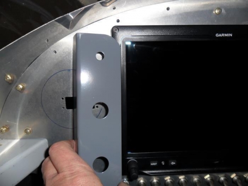

--Sprayed the throttle quadrant subpanel with gray paint to test for color and ultimately allow me to reinstall the prop governor cable. There is a bunch of work remaining behind the engine, but due to access issues, I can’t do any of it until the prop governor cable is back in place…so I have to paint something in the cockpit. Hard to explain, but that’s how it goes. Really like the color!
Oil temperature probe
Installed and safety wired
A preview of my panel color
