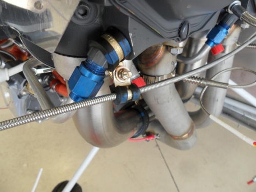

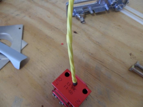

With that task at least partially finished, I set about working on cleaning up a few items that had been fitted but never fully installed. The oil cooler had to be removed, two AN fittings attached and properly clocked, then reinstalled with the oil lines in place. The throttle body came off and I removed the red cube, fixed a cut in the heat shrink (no idea how it got there, but there was a small nick in the insulation on one wire as well), reattached it and then put the fuel lines on. I found the throttle body gasket and using some Permatex gasket maker, reinstalled the throttle body and torqued the bolts (as best I could, access to that area is a bear…).

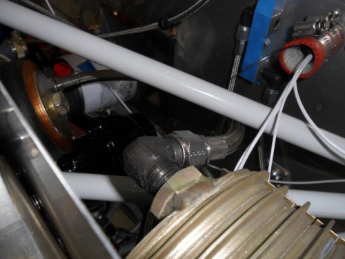

Finally, I reinstalled the manifold pressure line and alternate air source cable using a little bit more secure attachments. So far, so good. We’ll see what adventure awaits next.
