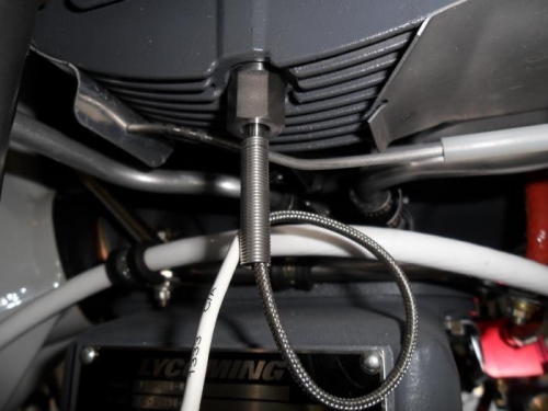

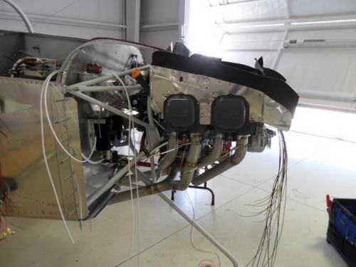

Today’s first order of business was cylinder head temp probes. This had to be one of the simplest tasks on the engine—put a little anti-seize compound on the threads, screw in finger tight, and then tighten to 25 inch lbs. With that done, I decided that I was going to take a look at the exhaust and see what I could accomplish there. Due to the extreme heat, the exhaust is a “work around” sub-system—meaning everything like fluid lines, wires, hoses, etc—must be worked around it to ensure that nothing comes in contact with a pipe. Until the exhaust goes in, there is a lot of guessing about clearances, so I figured it was time to install it. The process was pretty straightforward as the system is designed specifically for this engine/airframe combination. I still need to get a 12” extension to gain access to a couple of the aft nuts, but since I’ll have to take it off at least once more, I decided not to torque anything today.
The final project was installing the exhaust gas temp probes. These require drilling a #30 hole in each tube, between 2” and 4” from the flange, so I measured each one (I went with 2”) and used a punch to set a dimple in the proper location. After drilling each to #35 and then enlarging to #30, I trimmed the clamps down to size and installed each probe. Off to Oshkosh tomorrow!
Cylinder head temp probe

Looks good with the exhaust installed!
