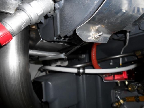

Rod #1...over an hour to make, but looks ok

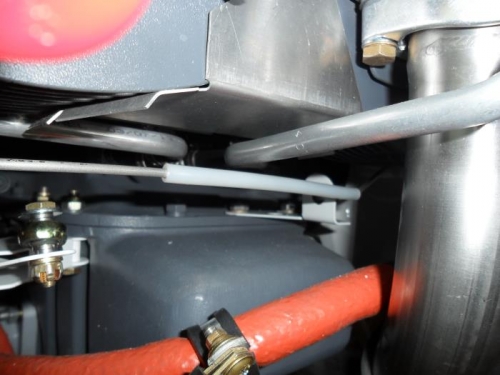

This is how it's supposed to look

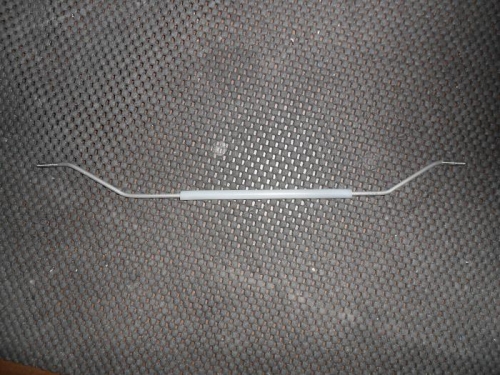

Tension rod #4...fifteen minutes, start to finish
