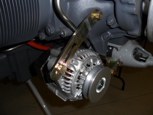

No wanting to leave without actually building something, I decided to fit the alternator. The alternator is attached with a bracket that mounts in a very specific place on the lower right side of the engine, so there aren't any options on locations for that. The plans suggest installing the alternator prior to fabricating the inlet air box due to access issues once the alternator is installed, so that made it a logical task to do next.

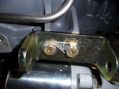

The first picture shows the primary attach bracket. This is held in place by two 5/16" bolts that require safety wiring. It’s been awhile since I have had to safety wire anything, and like riveting, it is both an acquired, and perishable skill, so after torquing the bolts, I practiced my safety wiring. When I was satisfied with the results (attempt #3, I think), I put the alternator on and finished up for the day. Lots more wiring—of the safety and electrical kind—to come.
It's been awhile since I practiced my safety wire techniques...

Alternator initial installation
