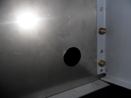

With about an hour left before I had to leave, I started the process of attaching the SafeAir firewall penetration brackets. The idea with these is to have a fireproof (or at least fire resistant) way of passing the wire bundles through the firewall to allow power to the aircraft and various engine sensors to provide data to the avionics. Since the mantra is "steel from the firewall forward", the SafeAir system provides a method of firesleeving the wires and protecting the interior cabin from flames and fumes.
The process is pretty straightforward--and the photos show the progress. Simply find a spot that is out of the way of everything else, cut a 1 1/8" hole in the firewall in two spots--one for power wires, the other for sensor wires, and then use the backing plate as a drill guide to drill the screw holes. Repeat on both sides and done. During the next session I will attach the firesleeve and start running wires through.

Another hole in the firewall
