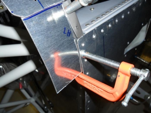

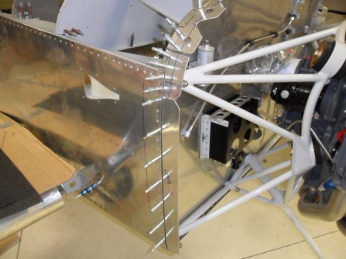

More sheet metal work as I continued fabricating the MilSpec cowl attach brackets along the top and sides of the fuselage. When I finished yesterday, I had the right top piece done, so I started with the left side and basically duplicated the process. Once the left was done, I realized that the .050" aluminum wouldn't turn the corner quite as well as I needed it to, so I elected to make a transitional tab on each side.
I took a long piece of pre-cut strip and bended it into a gentle curve to match the contour of the fuselage, and then cut two pieces to 3 3/4" for use as single tabs. Drilling to fit, filing, etc. I will drill the reference holes at a later time--probably once I get the rest of the cowl fitted.
With that done, I started working on the sides. Since those don't really have to be scalloped, that process went a lot faster, only slowed by my decision to remake the left side due to some edge distance issues on the first attempt.
