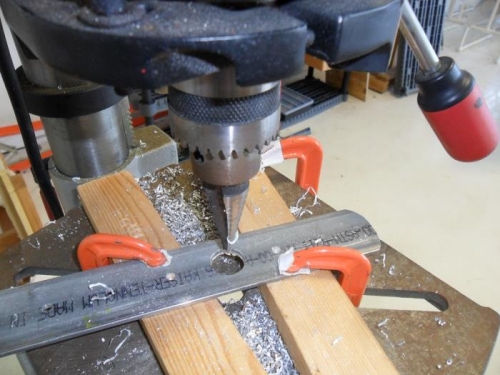

Continuing where I left off before the Labor Day holiday, I decided to add the optional lightening holes to the battery box and attach strap. One of those worked out great, the other resulted in an order for a replacement part. The strap is made of 1/8" aluminum stock--pretty easy to cut with a Unibit. After measuring for the holes, I made six pilot holes and then opened them all up to 3/4" per the plans. There is something about lightening holes that makes a piece go from "hunk of aluminum" to "aircraft part"...not sure just what it is, but I like the finished look.
The battery box didn't fare so well...trying to cut 2" holes in a steel box with a circle cutter was a bad idea. The cutting bit dulled after the first hole and I have no other way to make the cut. Pretty sure I'm not going to invest in a set of knock out punches, so I guess I'll just leave the new box as is when it arrives.

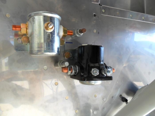

The rest of the time I spent working on attaching the master and start relays and trying to figure out where to have the fuel line come through the firewall. I have to say that the firewall forward plans from Van's leave a little to be desired. I spent an inordinate amount of time just trying to figure out what was supposed to go where--and in one case, the plans conflicted by having the fuel doubler attach at the same place as the start relay. Still not sure where I'm going to put that.
Adding some lightening holes to the battery strap

Master and start relays initial fitting
