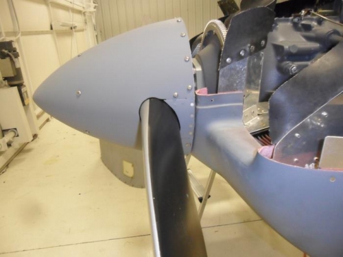

This was the final weekend before my airworthiness inspection next Thursday. I still had quite a few things on my list to finish up, so I picked back up at the nose and worked on the backing plates to complete the spinner. Fortunately I had saved the pieces that were originally trimmed out when I made the main cuts, so I used those to make the backing plates. The contour gauge gave me a rough place to start, and with the bandsaw and Dremel I quickly got the pieces trimmed to final shape. After drilling the plates, I primed them and then riveted them onto the main hub.

Initial fitting of the backing plates, still needs some trimming to clear the prop
Backing plates installed
