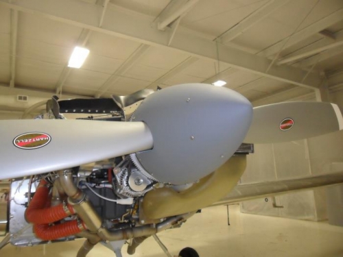

• Attached the spinner with stainless screws and nylon washers

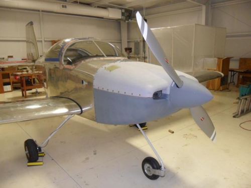

• Fitted the top and bottom cowls and checked for clearance from the spinner—good all around.

Spinner installed
Spinner installed
Test fitting cowling and spinner
