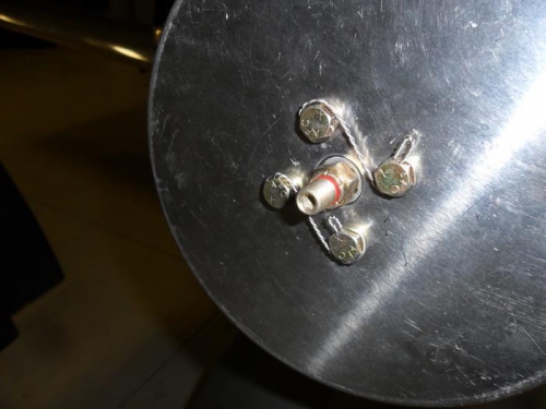

The afternoon was focused on installing the spinner, a task that took quite awhile due to the requirement to make a prop-shaped cutout on both sides of the spinner—and to try and get them to actually follow the curve of the prop. I ended up using a contour gauge for the rough shape, transferred that to a piece of cardboard, and then after trimming, fitting and trimming some more, used a piece of scrap aluminum for a test cut. Once I was satisfied with the basic shape I transferred the cut line to the spinner and got out the Dremel. The initial cut was intentionally undersized, so I used a sanding disc to progressively open it up until it followed the contour of the prop on both sides.
The next step was to drill the spinner and both the forward and aft flanges for #8 nutplates, a process well documented elsewhere in this log. I finished up by bolting the forward flange in place and test fitting the spinner. Looks good!
Forward spinner support plate
