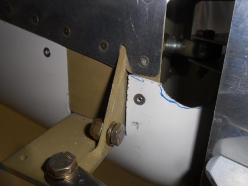

• Added bolts to the lower rudder horn to serve as adjustable rudder stops. Previously, although the rudder travel was at 32 degrees per the plans, the inside edge of the right elevator was catching the rudder at full travel. I may or may not have a ding in the rudder as evidence…

Rudder stop now limits travel to 32 degrees
