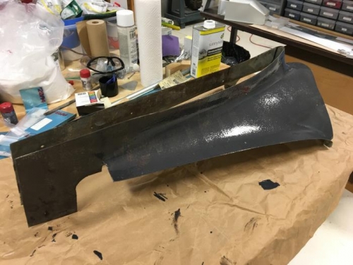

Another day of finishing odds & ends with the requisite frustration sprinkled in here and there for good measure. I picked up where I left off on the empennage fairing by sanding it down and then filling the misdrilled holes with some Bondo before covering the whole thing with a coat of tinted epoxy. I didn’t have to tint the epoxy for any reason other than I’ve found it easier to see surface imperfections, and since I had some left over from the windshield fairing, I just did it.

Coat of tinted epoxy on empennage fairing
