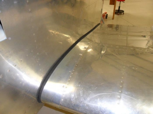

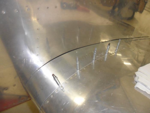

•Installed both wing gap fairings. Surprisingly this took a lot longer than I expected it too, primarily due to the fact that the fuel tank sealant was interfering with the nutplate installation, so once I got that cleaned off with a razor blade, the process went much faster. As is usual, the second one took half the time and was at least twice as good.

Left wing gap fairing in progress
Gap fairing complete
