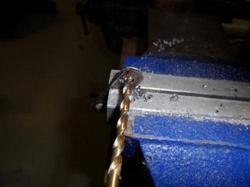

Next I installed the rudder pedals permanently. This involved climbing back under the panel and working in those close quarters to attach the bolts holding the nylon support blocks—including drilling two additional holes on the center support. I then measured the distance between my desired pedal location and the end of the cable attach bracket. After fabricating the F-6119 brackets from steel stock, I climbed back in and attached everything. Full travel on the rudders, but surprisingly noisy as the cables rub on the grommets. I have a plan for that...
Making rudder cable links
