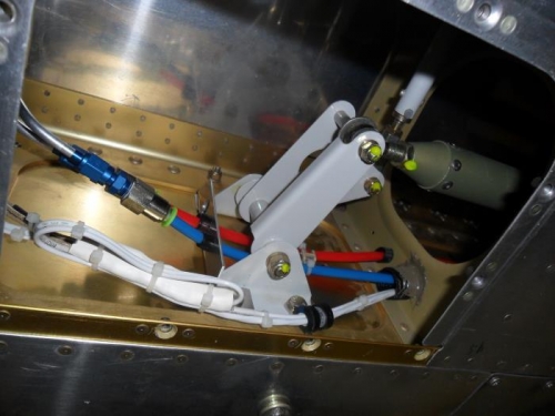

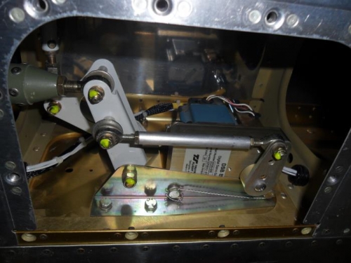

I had to change the bandsaw blade before I could do any work on the aileron stop, but once that was done, I started on the flight controls. Like always, the second time was both faster—and better—than the first attempt, and aside from the usual challenges of washers dropping on the floor, had the job done fairly quickly. The actual aileron rigging took quite a bit longer due to the steps required to get everything even. There are four adjustment points on each side of the aileron system—two on the pushrods from the fuselage to the bellcrank, and two on the pushrod from the bellcrank to the aileron. Each rod end bearing must be at least halfway into the pushrod, and one turn on even one bearing can move the aileron by almost ¼”. I ended up blocking the stick in a neutral position and clamping the ailerons to the wingtips to ensure everything was lined up. From there it was a simple (relatively speaking) matter of adjusting the rod end bearings to line up with the holes in the bellcranks. I finally got it all adjusted to my satisfaction, and after moving the control stick left and right, was happy to see full movement in both directions.

Left wing bellcrank and wire routing
Right wing bellcrank, wire and autopilot servo
