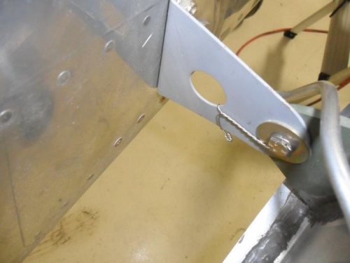

•Torqued both forward fuel tank bolts and added safety wires.

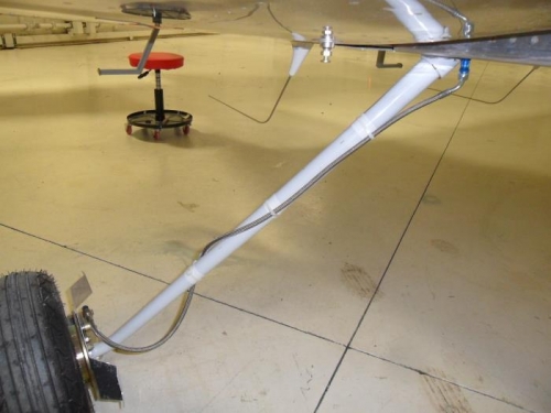

•Secured brake lines to main gear legs and tightened all external fittings. I’m evaluating the necessity of replacing the bolts shipped with the brakes to change over to bolts with drilled heads in order to safety wire them. It seems that if Matco doesn’t require safety wires, I wouldn’t need them…but most brake applications I’ve seen incorporate that extra step for security.

Forward fuel tank attach bolt torqued and safety wired
Right brake line secured to gear leg
