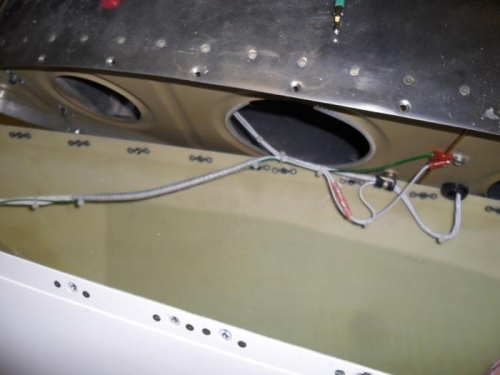

Today was a marathon session with the goal of finishing the wingtips and moving on to attaching the cowling. I started by doing the final wiring on the left side for the nav and landing lights. Since I may have to remove or replace the nav lights some day, I used D-Sub pins as connectors and added a double layer of heat shrink over the whole assembly to provide protection. I used a simple butt joint for the landing light, but left some extra wire for future changes if necessary. Since there will be no way to visually check this area, I added an Adel clamp and some grommet edging in the lightening hole to provide wire support and chafe protection. After testing the lights one more time I attached the wingtip with screws and moved to the right side.

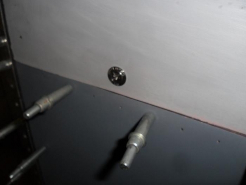

After putting the cowling back on with clecoes, I started evaluating the best strategy for attaching the camlocks. To ensure that it all fits when I’m finished, I’ll probably have to do a lot of on & off adjustments and mark each camlock location as I go, so I found the place to start and installed the first one as a test. It was a small milestone, but it marked the beginning of the last major assembly on the aircraft.
