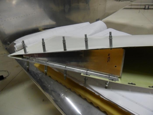

After spraying the cowling, I pulled both wing tips off and began the process of fitting the aft ribs in each. The plans call for a ¼” gap between the aileron and the trailing edge of the rib, so I had marked those lines before I removed the tips. The Dremel tool and a sanding block made quick work of the trimming, and then I finished the process by the usual aligning, drilling, countersinking, deburring, priming and riveting—all very routine at this point in the build.

Wing tip rib drilled in place
