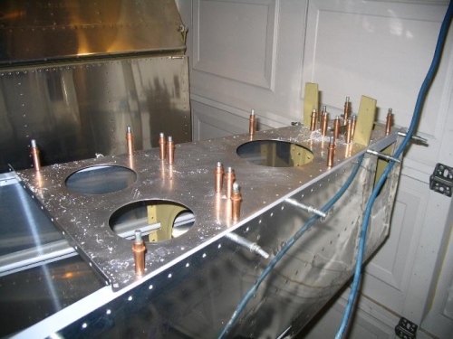

Today I fabricated a couple of brackets and spacers that attach the aft deck to the F-710 and F-711 bulkheads. This is also the primary attach point for the horizontal and vertical stabilizers, so there is a fair amount of aluminum here. One thing I found was that I should have attached the F-710 bracket to the bulkhead BEFORE I riveted the bulhead into the fuselage...no big deal, but drilling it was a little interesting. Waiting for a warmer day to prime, then I'll rivet the aft deck in and move on to the upper fuselage skins...or maybe the firewall gussets...or maybe the static lines...
Aft deck after final drilling
