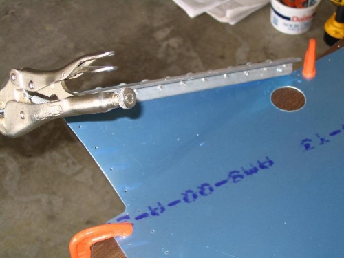

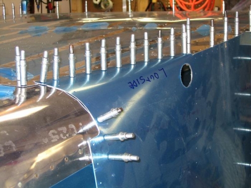

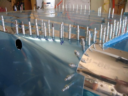

Drilling and bending were the order of the day. I started by removing the right F-770 skin and drilling a piece of scrap angle to prepare for bending the aft portion of the skin where it blends into the lower aft fuselage. After drilling the angle, I attached a pair of ViseGrips and started bending. A couple of trial fits later, the skin fit and I was ready to reattach. Before I did that, I drilled the F-715 outboard seat rib to the floor skins and then put the F-770 skin back in place. The same process got the left skin done in short order and I moved on to the longerons.
