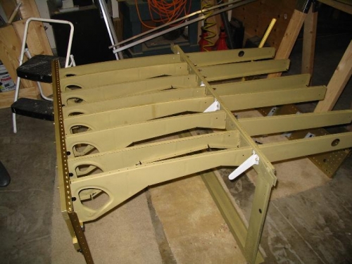

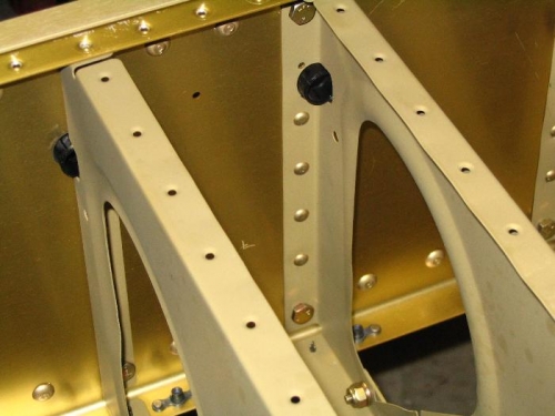

This session was spent in the initial construction of the center section. The first step was double checking everything to ensure all was ready for riveting. I had to go back and dimple the F-705 bulkhead which posed two problems due to the seatbelt attach bracket nuts interfering with the Tatco as I was trying to dimple--that lead me to use the pop-rivet dimpler, which worked ok. I also realized that four of the seatbelt attach brackets interfered with the seat ribs, so off they came and after a little grinding, cleaning, and touch-up paint, they were back in place.

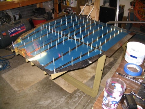

Then I began riveting the structure together. For the seat rib/F-704 attach rivets, I shot them with the gun, but I used the Tatco hand squeezer on everything else because I've found I have much better control of it, and it's easier to adjust, so unless I have a bunch of similar rivets, I generally squeeze them by hand. After a bunch of riveting, I clecoed the skin on and called it a night. I think I'll be able to shoot most of the rivets myself as the access is pretty decent. We shall see...
Center fuselage structure riveted together
Forward center section detail
Bottom skin clecoed in place
