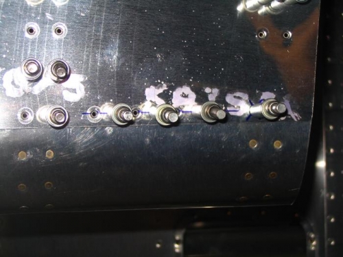

In my previous post, I mentioned about my communication with Van's regarding adding extra rivets to compensate for some elongated holes. The elongation is only on the aft tailcone skin, which is sandwiched between a fuselage stiffener on the inside, and the F-773 skin on the outside. I wasn't too worried from a structural standpoint, but felt better having a little "insurance", so I added three rivets on each side to ensure the assembly was sound. Now I'll take everything apart for final preparation before riveting.
Additional rivets added to aft tailcone
Another view of rivets
