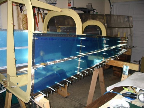

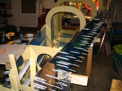

After dimpling all of the skins, I reassembled the structure to check for final fit before riveting. There are a couple of spots that I need to bend the bulkhead webs for better fit, and I still have to drill and dimple the rudder cable clamp attach points and drill out two more bulkheads for the rudder cable grommets. When I drilled the aft tailcone skin, I found several holes that had become elongated due to some misalignment of the skin. I e-mailed Van's to get their opinion on what to do and will wait on riveting until I have a plan. What does this all mean? I get to take all of the clecos out one more time!! Well, I'd rather get it right and be happy with the results...what's the rush?
Fuselage assembly after dimpling
View from aft
View from aft
View from front...still a lot of work ahead!
