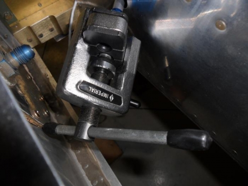

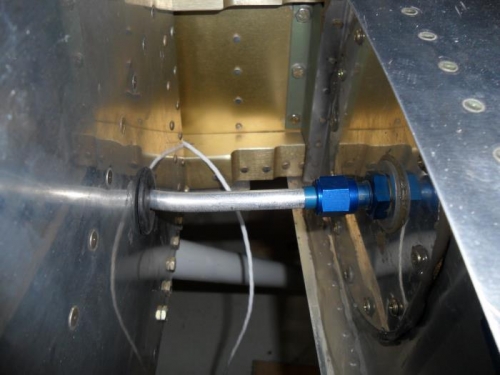

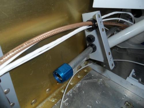

Turning to the fuel system, I started working on an issue that had bugged me for awhile. As previous posts detail, my attempts at getting professional tubing bends had proven somewhat futile, and after two attempts at using 3003 for the wing-to-fuel selector, I had “settled” for good enough. Not really wanting to settle, I purchased some 5052 awhile back and had used it, with great results, to plumb the filter-to-fuel pump and pump-to-firewall runs. So, tonight I pulled out all of the 3003 from the fuselage…and unceremoniously dumped it on the floor. I figured out that by using a union between the wing and the selector, I should be able to navigate one piece through the gear mount and out the fuselage, and a second piece could be easily bent and installed in the center fuselage. It turned out that a sweeping “prebend” was necessary, along with removing one of the support brackets, but after one unsuccessful (crimped) attempt, the second one was good. Very tough confines to do the outboard flaring, but I think this will work. Enough for one night…
Tight confines for flaring
Left side fuselage entry point
Ready for union
Ready for union
