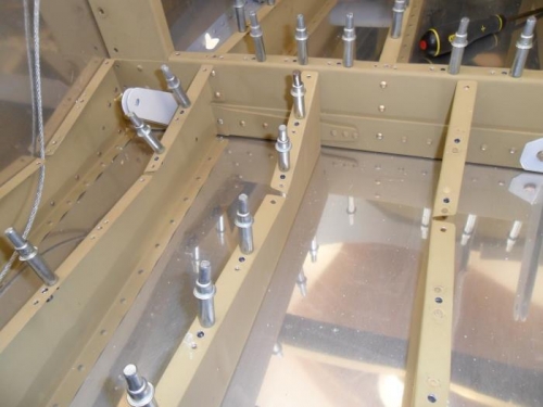

Brief Description:  Installing nut plates for cabin and baggage floors
For a long time I have avoided the decision of how to attach the baggage and seat floors. This was primarily due to the fact that the plans call for using blind rivets and this makes the installation permanent. But what if I need to remove the floor to run wires or install some component? Many builders use nut plates for this purpose, and so I finally decided that was the best option for me. Unfortunately, nut plate installation is a bit mind numbing so it's not something I relish.
80+ nutplates to install...oh well, it is getting too cold to do much more with the canopy for awhile so why not?
