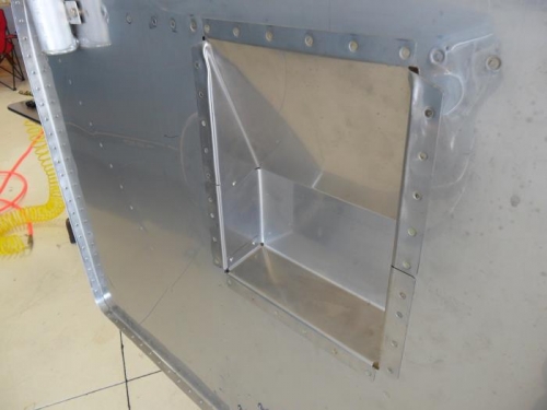

Today I headed out to the hangar intent on getting the firewall recess riveted in place. I started by finishing up some edge filing and after the normal fitting and adjusting, riveted it all together. There is something about having that closed up that makes it seem much more finished. I gave some brief thought to hanging the engine mount, but after looking at the 3/8” bolts and realizing that I didn’t have a suitable reamer, I decided to wait. I haven’t gotten too wound up about using a reamer to get every hole perfect, but those that attach the wings, tail & engine do get a little more consideration. I’ll buy a used reamer at the local junk store and use that for the six holes I need to drill.

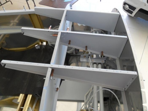

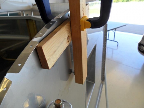

During the process of installing the foreward fuselage ribs I realized that I had never dimpled the 10 or so holes in the upper part of the firewall. So, how do you get a dimple die in place to do this? The picture shows my plan...and it actually worked. Go figure.
Recess installed
Recess installed
Necessity is the mother of invention...
Foreward fuselage structure back in place after priming
