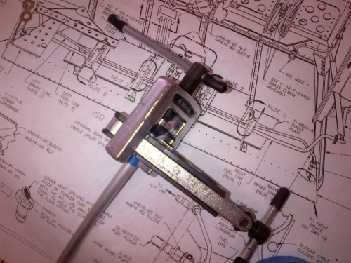

To celebrate my progress, I spent about 2 hours ruining six feet of fuel supply tubing trying to figure out how to get it through the various bulkheads, gear mounts & fuselage. The builders manual says "the plans are so detailed that any further description would be redundant". Pretty funny. Reference my previous post where some builders leave the gear mounts loose until they get the fuel lines in...right. Not sure who came up with that idea, but I can't see how that would make any difference.
There seems to be two options. First, many people use a flexible tubing bender to "guide" the tubing through the double 90 degree turns necessary to clear the gear mount--this is the method I will be using with the replacement tubing when it arrives from Van's. Other builders have paid about 140 bucks to have two flexible tubes made. That will be my plan B if I can't get this right...but I'm optimistic to a fault. We'll see...until next time.
Flaring 3/8
Flaring 3/8" fuel supply line
