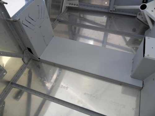

Today I finished up the forward cabin covers by adding four nutplates, two per side, that secure the center cabin cover to the floor stiffeners. Following this, I decided to test fit everything to make sure it all went together properly. I found some of the brackets needed a bit of adjustment, and I hope these covers don't come off very often once the aircraft is built--they are tough enough to install with no interior...can't imagine how tough to get to once everything else is in the way.

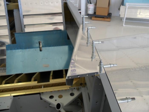

Finally, I started working on the cabin side rails and forward canopy decks. These were pretty simple, just needed to fit and drill to the longeron. Next session I will probably prime and install these parts to get ready for working on the forward skins and firewall.

Center cabin cover installed
Side rail and forward canopy deck
