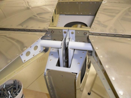

After measuring the stab tips to the fuselage about five times to ensure it was even, I clamped it in place, measured it again, and then measured for the bolt holes. The two outermost holes must go through the center of the longeron...which of course is completely hidden from view, so I used the row of rivets running fore and aft that attach the aft deck to the longeron as a reference. I figured that those rivets were centered, so the bolts would be too. Turns out I was right.
The four aft bolts were easy since I had pre-drilled the holes in the F-711 attach bars way back when I was working on that bulkhead. I simply checked the incidence at 0 degrees by putting a 3/8" shim under the aft spar and match drilling through the spar. With the exception of the vertical stab, I think I'm about done with putting holes in my carefully made airplane parts.

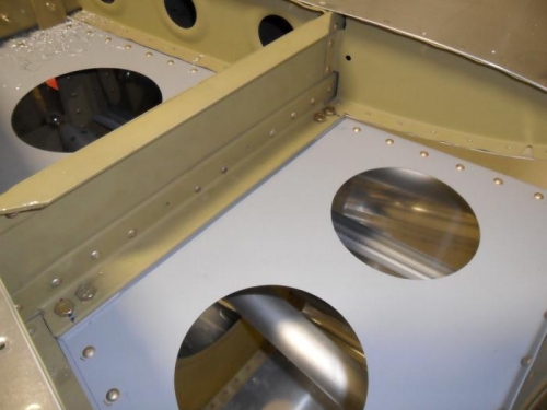

Holes through spar and aft deck

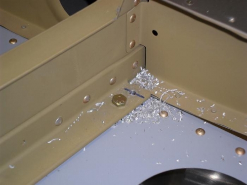

Bolts in place, no going back now
View from aft of horizontal stab attach bolts
