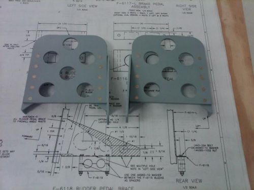

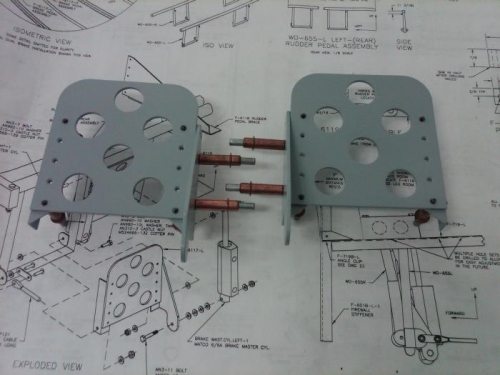

A short session focusing on getting the rudder pedals ready for installation. After roughing the surfaces with a ScotchBrite pad, I cleaned and primed them. Following that, I riveted the brackets and the pedals. Ready to attach to the rudder pedal assembly.
Ready for riveting
Ready for riveting
Riveted and ready for installation
