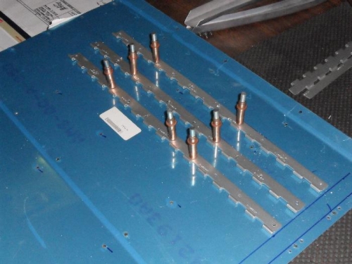

Today was mostly a lot of measuring, marking and cutting. The seats in an RV-7 incorporate the floor as a part of the structure--specifically, as the seat pan. The seat back is adjustable in three (I suppose a builder could make it four or more) positions fore and aft. To accomplish this, I cut hinges into sections that will be blind riveted to the floor in three places. The photo shows how this is done so not much else to say about it. Two seats, six hinges.
Seat hinges drilled to floor
