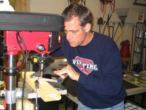

Disassembled right wing structure and deburred all holes. Used Unibit in drill press to drill 13/16" holes in all ribs for wiring conduit. Conduit will be used to run wires to nav, strobe, and landing lights. Began sanding ribs for primer application.
Drilling holes for conduit
