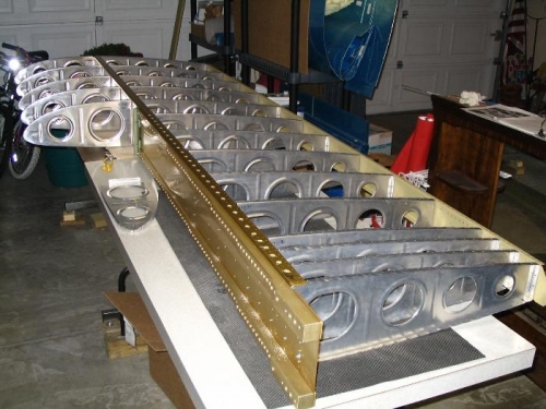

Assembled both right and left wings, match drilled all rib to spar holes, deburred holes in left wing ribs. Located and drilled holes for electrical conduit in left wing ribs -- will have to address a bend in the conduit around the aileron bellcrank.
Left wing ribs and main spar

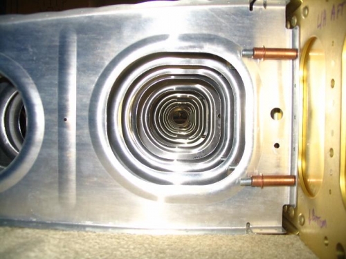

View through lightening holes

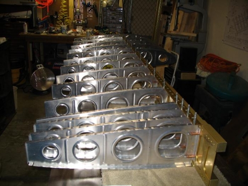

Right wing assembly
Right wing assembly
