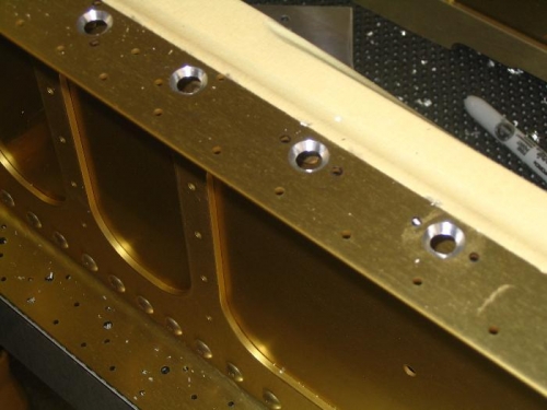

Brief Description:  Wing spar prep
Began countersinking fuel tank attach holes to accomodate #8 screws and associated platenuts. Used a piece of angle stock to make a guide for countersink center. Only one quarter of the way through the countersinking process, but the next three sides should progress more quickly.
Countersunk holes w/ tape to deflect shavings
Cleco clamps to hold the guide in place
