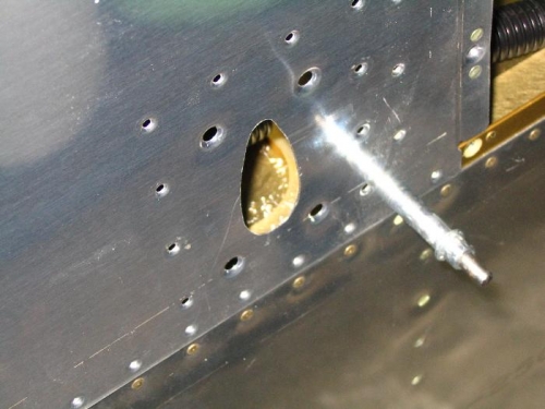

Since I'm going with a heated pitot tube, I needed to install a special bracket that requires positioning and cutting on the lower wing skin. By this time in the overall project, this type of work is really pretty simple (I think about how long this would have taken a couple of years ago!), it's just a matter of looking at the plans, making all cutouts a couple of times in your head...then getting to work. After ensuring that I was working on the correct wing (never assume!!), I started the process. The photo shows the cutout and installation holes that will be used to rivet the base plate in place during final wing riveting. The pitot tube just slides in place and is secured with four #6 screws.

Pitot tube cutout
Pitot tube cutout
