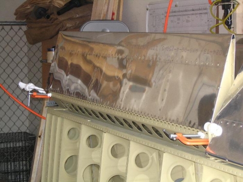

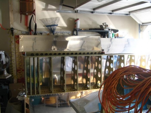

At the end of the session, I clamped the flaps in place to begin the process of aligning them with the ailerons and drilling the hinge for final attachment.
Flaps clamped in place
