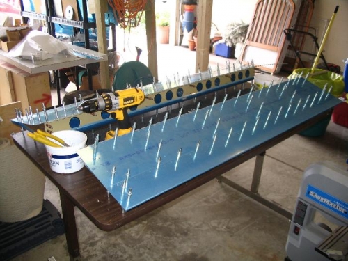

Today I just kind of eased back into construction by working on the flaps. I first reorganized my workspace, and then I assembled the flaps and match drilled everything. One of the things I can't figure out is why most of the kit fits perfectly together, but every now and then you run into a thing like the flap ribs and aft spar--they are supposed to butt against one another, but the ribs are about 1/16" too short. The building instructions call out a thin shim if necessary...why not just make the ribs longer? Oh well...

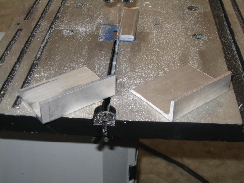

After drilling all the skins, I fabricated the flap attach brackets using the bandsaw and belt sander...pretty quick work. Then it was a bunch of measuring, drilling, and deburring before calling it quit for the day. I'll be back at it this weekend!!
Flaps after match drilling skins
Flap attach brackets
