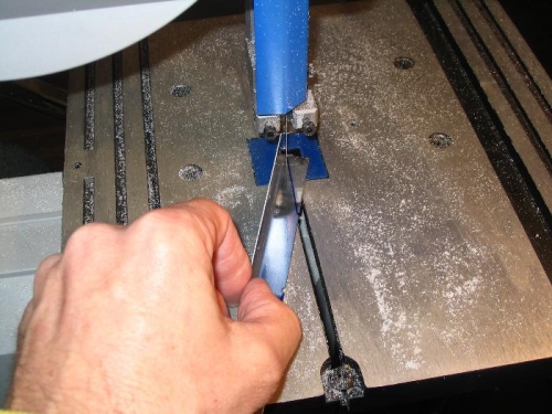

After removing all of the plastic, I marked the aileron stiffeners with a sharpie and started cutting with the snips...suddenly I remembered the bandsaw that I had purchased for just such a purpose. The bandsaw made quick work of the cutting, and after a quick pass on the belt sander, I deburred all of them on the ScotchBrite wheel. I have to say that making stiffeners is not my favorite part of homebuilding.

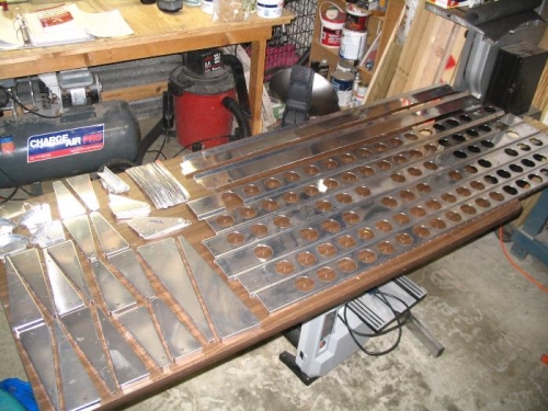

Once the stiffeners were done, I used the ScotchBrite wheel in the bench grinder to work the edges of all the parts for the ailerons and flaps...this is a lot of parts! I finished by using my high-speed rotary tool with a small ScotchBrite wheel and worked all of the lightening holes in the long braces and gap seals. Next up will be fitting, match drilling, and assembly.
Cutting the aileron stiffeners
Aileron and flap components after working edges
