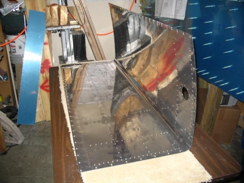

Brief Description:  Fuel tank prep
Finished dimpling the tank ribs (I had to go back over them and dimple them with the fuel tank die...forgot I had it!) After re-dimpling the ribs, I dimpled the tank skin with the same dies, then used the larger dies to dimple the screw attach holes. Next session...scuff the skins and proseal the tank stiffeners...yikes--it's proseal time again!!
Right fuel tank skin dimpled
