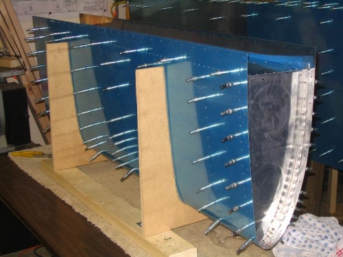

Brief Description:  Right tank prep
The third time is a charm! I successfully drilled the T-712 bracket and then assembled the tank in the cradle. Because the tank is made of a thicker guage of aluminum, it is much more difficult to get the ribs to fit, therefore, you have to ensure that the ribs are as straight as possible. Next up, match drilling all holes, then deburring, dimpling, and getting the capacitance fuel system ready for installation. Still a couple of weeks away from Proseal...
Right tank in cradle, ready for drilling
