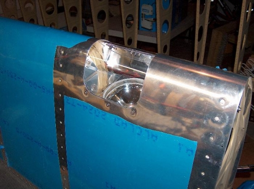

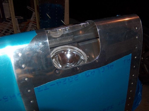

Tonight I finished the landing light by first countersinking the lens to accept the skin dimples from the screws, then I attached the brackets that hold the landing light lens in place. Finally, I cleaned the lens, then inserted it into the bay and tightened the screws.
View into landing light bay
Landing light installed
