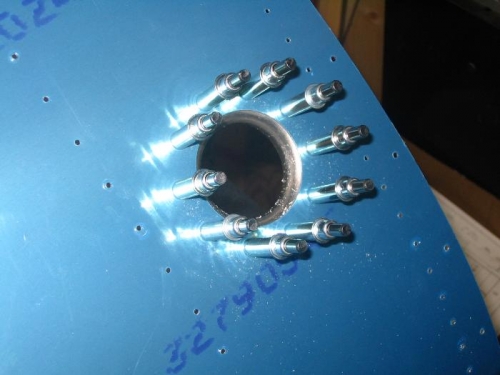

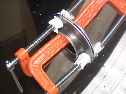

Brief Description:  Fuel tank prep
Marked position for the access panel reinforcing plate and the cover plate. After drilling the rib flange for #8 screws, I clecoed the reinforcing plate in place and drilled #30 for the platenuts, then deburred and attached the plate and platenuts to the rib. I then moved to the fuel filler flange, marking the position, then clamping and drilling. I did the same thing for the fuel drain on the lower skin. Finally, I fabricated two anti-rotate brackets for the fuel pickup tubes and called it a night. Lot's of prep work, not a lot of obvious progress! The next step will be to dimple the skin, then on to sealing the tank.
Access panel reinforcing bracket in place
Fuel filler flange ready for final drilling
