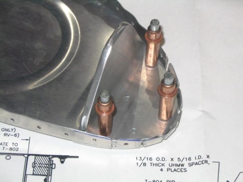

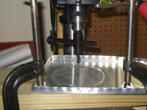

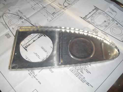

I began the session by finishing the T-405 tank attach bracket. First I adjusted the fit, then marked the location for the six rivets that attach the bracket to the rib. After drilling, I then clamped the reinforcement plate that fits on the inside of the rib and final drilled #30. Then, I used a fly cutter to cut the access hole in the inboard fuel tank rib. After cutting the access hole, I smoothed the edges, then began the process of aligning the reinforcement plate and cover to the access hole.
Ready to cut access hole
Access hole cut in rub
Wing attach bracket final drilled
