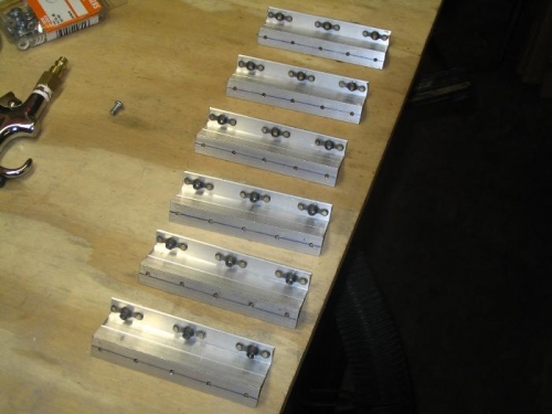

Began the session by drilling the tank skin-to-spar attach points to #19. After this, I drilled each attach bracket for the platenuts, then installed platenuts after deburring. Finally, while I bucked, Beth shot the six rivets attaching the inboard platenuts to the aft side of the spar.

Tank attach brackets with platenuts installed
