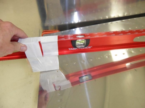

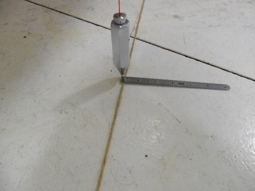

After leveling the fuselage and checking the sweep one more time, I used a 3" block and the level to check for the proper incidence. The manual says that the actual incidence is less important than having both wings the same, but I guess I feel better having both parameters met. This meant that I had to file a little bit off of the right spar to gain clearance from a rivet to raise the spar about 1/16", but once this was done both wings were the same and the incidence checked per the plans. Time to drill.

Checking sweep one more time
Using a level to check for incidence
