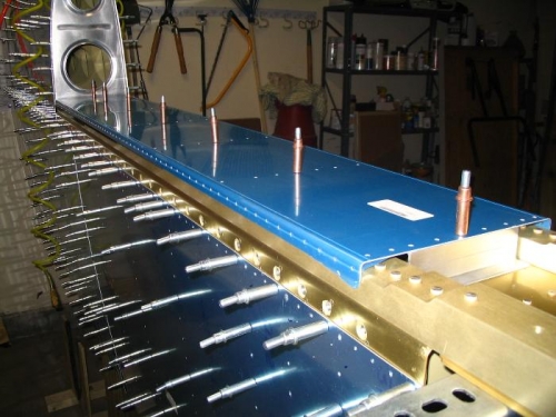

Bolted Z-brackets in place to check initial fit of aft tank baffle. Then placed tank skin in position and clecoed to spar and baffle. There is a slight gap (1/16") at leading edge, otherwise the fit is perfect. I'll work on the baffle a bit to adjust the fit, then will remove the skin to begin actual construction.
Tank baffle initial fitting
Tank skin in place for fitting
