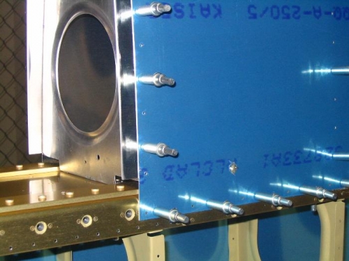

Had to remove the leading edge to ensure all holes were aligned properly prior to final drilling. After reinstalling the leading edge, I added a bracket to the lower section of the wing stand to keep the wing more stabilized. Following this, I fabricated the fuel tank to leading edge joint plate, then positioned it and final drilled the skin to the joint plate and inboard rib. I now have to final drill the remaining rivet holes in the leading edge, then on to the fuel tanks.
Inboard rib fitted and drilled
